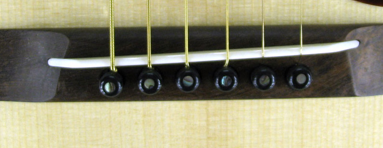

PostPosted: Mon Feb 13, 2006 10:51 am
Posts: 908
let's say you put the bridge pins right up close to the saddle
Like this? <g>
PostPosted: Mon Feb 13, 2006 12:08 pm
Posts: 2687
Okay, my point wasn't really about having the pins right up close to the saddle, it was about changing the geometry of the bridge, however that is accomplished, such the saddle height is the same relative to the top of the guitar, but the string break angle is sharper.
So, my questions remain about what the mechanical effect of this would be and what the resultant difference in sound might be...
Todd Rose
Ithaca, NY
